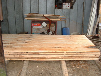

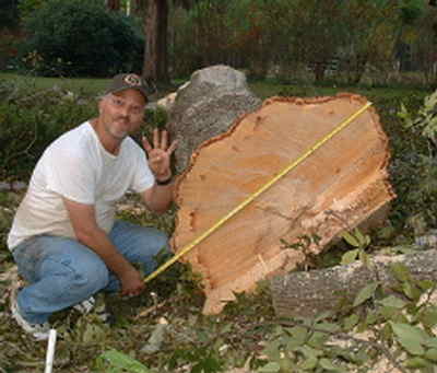

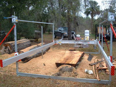

Here is a hickory tree I cut down a couple of years ago from my front yard. It was over 40 inches in diameter at the butt of the log.
I milled it into 1x8" boards using a Peterson Swing Mill (one of 3 sawmills I own)
the lumber was stacked and stickered and has been sitting there for 2 years.
Soon, you will begin seeing a few guitars made using this wood. There is a long way to go before I can use this wood for instruments though.
